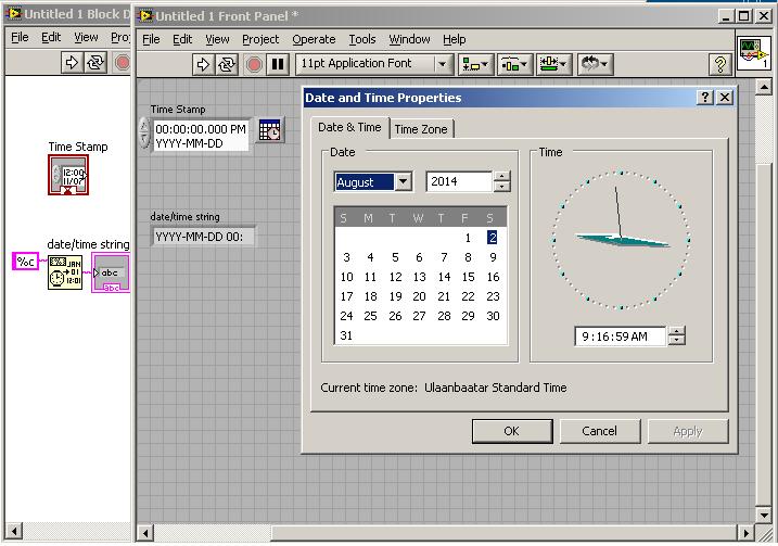

My Problem is my Labview TimeStamp cannot display current system date and time.
Please see my attachment for the screentshot.
The TimeStamp or ever Format Date/Time String display "YYYY-MM-DD" instead of  "2014-08-02".
I tried other computer machine and it works. There are some computer machine has this problem.
How can I resolve this issue? Please advice. Thanks.

Bill,
reviewing the thread Dennis linked (thanks for that) reveals that it is the same account which opened this thread here three month later.
What bothers me is the fact, that the past thread is marked "solved" even though it obviously isn't. Or the OP is trolling us.....
Nevertheless, it seems like systematic error. Connected to specific machines.
What makes the machines where the time stamp issue occurs "unique"? If there are several, is that source really "unique"?
Most obvious reasons would be:
- Language settings (possibly the infamous "dot-comma-issue")
- Time zone settings (e.g. what happens if you switch Ulaanbaatar to Perth or maybe even some US time zone?)
- Missing hotfixes for Win and LV
- Is the system running as virtual machine vs. "native"?
Not so obvious differences:
- Specific CPU type
- Motherboard/BIOS
- LV ini settings
There are tons of other possible reasons (e.g. corrupt LV installation), but these are the ones i came up with within a couple of minutes....
Norbert

Again "<%c>" (A container of formatted time information) would be the prefered local specific date and time format string  "<%x>" would be the local specific date.
Use scan into string instead
Windows is corrupt on that machine.
