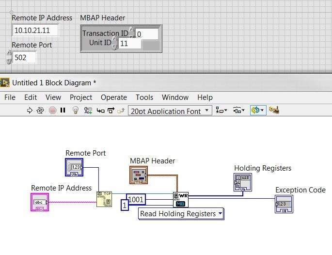

I am trying to poll modbus data from a device that requires that its slave/device id be specified. I'm not sure how to do that in LabVIEW. I have other devices on the network that do not require that parameter, and this code works for them:
I also know that the rest of my parameters are correct and my slave is properly networked because I am able to poll it using CAS Modbus Scanner with the correct device ID specified.

I figured it out (of course, immediately after posting).
It's in the MBAP header. The MBAP header is a cluster of the transaction ID and unit ID, and is an input to the MB Ethernet Master Query.vi. I made it a control to specify on the front panel. I don't know anything about the Transaction ID, but specifying the Unit ID is what I was looking for and I'm able to poll the data now.
