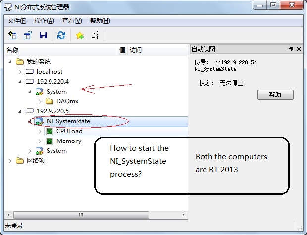

How to start 'NI_SystemState' process?
In my Distributed System Manager, I found NI_SystemState process on one of my RT systems.
I don't know when and how the process was started.

The Application Engineer of NI Tao li | tao.li@ni.com pointed out the result.
The process is published by the RT system itself. I need install a server named 'systemstate published' to the RT target.
https://knowledge.ni.com/KnowledgeArticleDetails?id=kA03q000000YHdDCAW&l=en-US
http://digital.ni.com/public.nsf/allkb/F4D776187EFCC30986256EFC007FC922?OpenDocument
