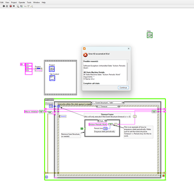

I have one question maybe you know a better way to do it. Sometimes i run my program and make something stupid like no way to get out from while loop and i got error. Is there any way to stop this program without killing labview in taks manager? Because every time i have to do it and re-open every vi on project.
Here is example with this situation:
Clicking red :"stop" button not working because i have error and when i click continue it just shows again.

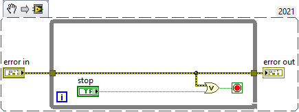

To stop a While Loop when there is an Error, simply wire the output of the Error Line (which you show on your picture of one case of your Block Diagram) to the conditional "Stop" indicator.  About a decade ago, LabVIEW changed the Boolean functions (such as "Or") to allow either a Boolean or the Error Line (which is a Cluster, the first element of which is "status", True if there is an Error.
When you have a program with loops that you want to stop (or take some other action) if an Error occurs, use the Error line to trigger the "Do This on Error" condition (here, it was "Stop the Loop").
