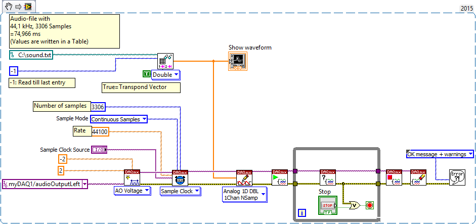

A few wrong things in your vi. Never configure/clear task over and over in a loop, Configure once before and clear after. A time loop is useless, the timing is performed by your sample clock.
For what you want to do set the generation mode to continuous, it will generate the buffered data over and over again until you press stop.

thank you very much for you answer! I just changed my VI according to your advice and it generates a constant output and repeats endless which is very good :-). Some further questions came to my mind:
  1. As soon as the task is startet, I guess the values of the array are "uploaded" to the hardware and are running and running until you press stop the task? I am wondering why the loop now has a cycle time of 6 seconds?

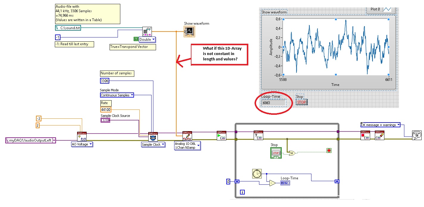

  2. Now I want to implement a function, in which the Sound-File can be "streched or compressed" in the time-axis, which I thougt is possible with the "arbitrary-wave generator". But then the array will have no constant length any more. For example: In the first iteration, the length is 3000 values, in the second 3120, in the third 2900 and son on... And these iterations should be set one behind the other without break. So how can I implement this. As far as I can see, with your configuration its only possible to configure the array one time?arbitraryWave.JPG

6 seconds is very odd, is it constant?
Ben64
(4,171 Views)
Hi ben64, I must correct myself, it only between 15-16 ms, I tried it again. I dont know why it was at the first try 6 seconds....

This make more sense. I don't know about the 6 seconds, if you ran only 1 loop iteration and got this value it can be explained by the shift register initialized to 0 instead of being initialized with the tick count function (also the tick count roll back to 0 when it reaches 2^32-1). It is expected that the loop delay is different from the time it takes to generate 3306 samples, in the loop we are only polling the task status repetitively.
I'm not sure what is your goal with the second part of your questin, why don't you just concatenate the 3 pattern arrays?
