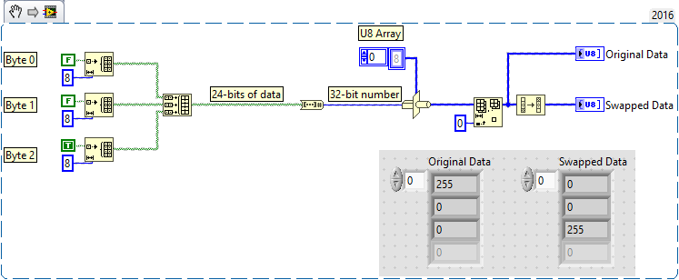

LabVIEW does not have a 24-bit number, so when you get your data, you can convert it to a 32-bit number, and then to an array of Bytes which will have 4 elements. Get rid of the first Byte and you will have your 3-byte array. Then you can reverse the array order to swap the 2 bytes on the ends.

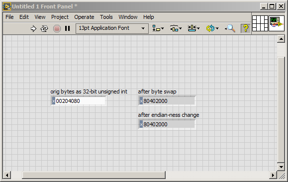

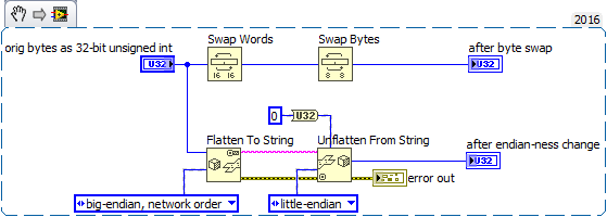

LabVIEW also has direct functions for doing byte and word swaps (as well as splits and joins).  You can find them under the palette Numeric-->Data Manipulation.
Another thing that may be useful there is the pair of functions "Flatten to String" and "Unflatten from String".  They can also be used to reverse byte order by setting endian-ness.
Below is a quick illustration of both:
-Kevin P

Of course you can use a rotate or shift (after the swaps or unflatten) to go from 80402000 to 00804020 if that's what you want.
