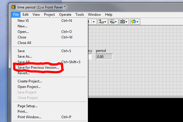

Well, you need to compare previous values to current value and detect if it passes a threshold (which you decide).
There are functions for this, so if your data is "easy" changed into eg waveform, then do that instead of re-inventing peroid detect.
Without knowing your code, i can't be more specific...
you can save in earlier versions Smiley Happy
