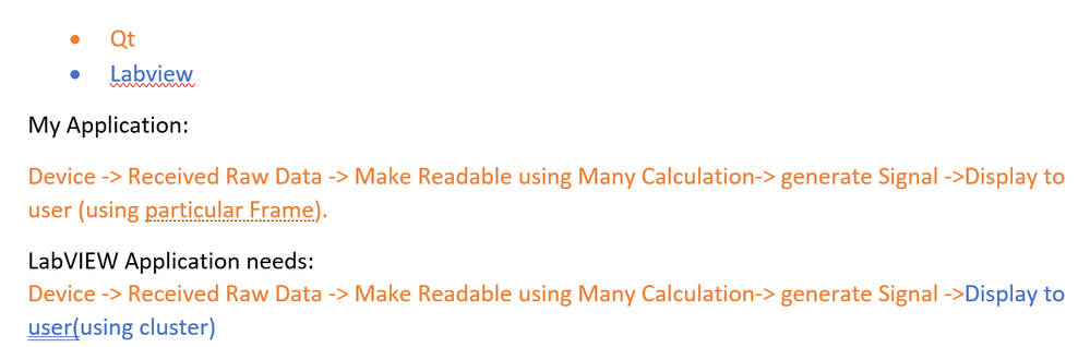

Qt data signals has double value. once raw data is received from device, then data make readable by some calculation, after that it is display to user. In my application it is display I directly display on Qt form by connecting slot, but Here I want to display readable data to Labview Application.

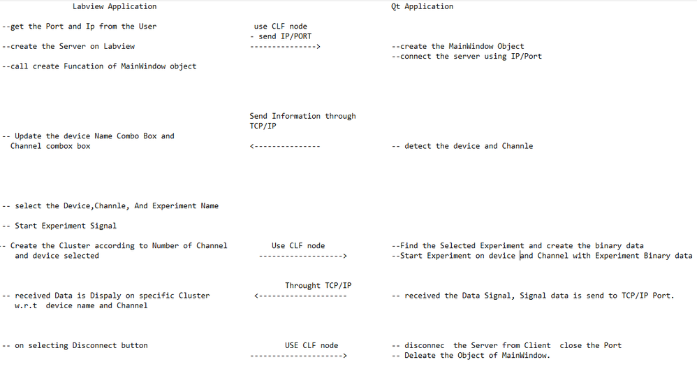

Thank you for reply. I know calling of DLL using Call Library function. but here I don't want call any function from Labview to Qt application.
Whenever the DataSignal is generate at time I wanted to call Qt Application to Labview Application and update the value inside the cluster.
Yes Qt has TCP/IP interface API.
Here I mention, whatever I am wanted to do.
Top Overview  Lab view Interface:
(3,721 Views)
I am not clear on the specifics of your problems. You are mixing calls to the DLL with TCP messaging. These are not the same things. If the QT application has a TCP messaging API it should be documented and you would use the basic TCP primitives to communicate with the application. I don't see why a DLL would be needed in this case. If you are using the DLL then I am not sure what the TCP communications provides unless it is strictly for data streaming. We have no information about this QT application so giving anything more than the most basic advice would be impossible.

Here I am using "Call To DLL" for calling specific function into dll. but from your advise I think I just need to use TCP/IP for both way communication.
Yes, I am using TCP/IP only for data streaming from Qt to Labview.
