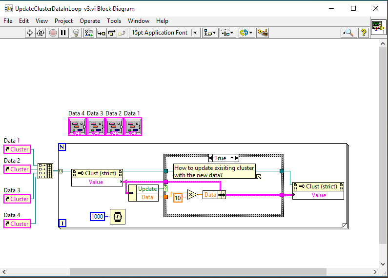

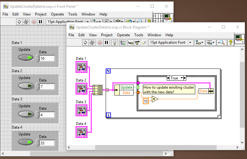

I need help updating my cluster varible after indexing it through a for loop.
I have multiple cluster variables which I bundle into an array. I index the array in a for loop and check to see if for each cluster variable needs to be updated. If it is updated, I multiply the data value by 10. I want to update the data of that cluster to show the new value (old data * 10).
How can I do this?

You've done the work, now you have to "output" the work.  Right now you aren't doing anything with your updated data.  Just wire the output of the Bundle by Name out to the edge of the For Loop and pass it on from there to whatever code gets it next.

Use an Autoindexing Tunnel for an output of the FOR loop, Index Array to get your individual clusters.  Assuming this is a subVI, write to indicators.

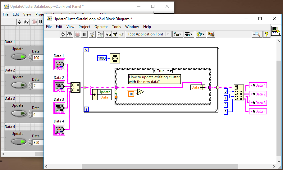

Thank you, your suggestion worked. However, I feel I didn't implement it in the correct way.
Additional questions:
  • How I have is such that after ever iteration of the loop, the respective data is updated right away. Currently, all the data updates at the end of the entire loop.
  • I had to create a local variable and manually map out each of the indexing. Is it possible to do this automatically?

Your question is a little bit unclear, I don't think anyone knew you wanted to modify the values of the input controls. As far as automatically, you do not need to specify the indices explicitly on "index array", it will start at 0 and increment with each output. Or, if you wire the first with "n", the next will be "n+1" and so on.
Perhaps you should reconsider your datatype so you are working with arrays, if you want each element to go where you want it "automatically".

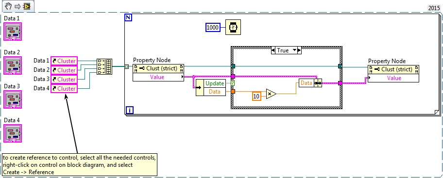

If you want to update controls values, you can use not just local variable, but property nodes - and references to controls; check VI snippet below:
Sincerely, kosist90
Message 7 of 9
(5,212 Views)
kosist90
Wow thank you very much. Your solution worked! The other solutions such as "create array of clusters on the front UI" wasn't feasible for what I wanted to acheive. Using Reference/Proprety NOde got the job done. 🙂
