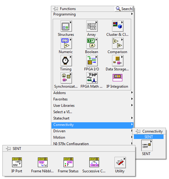

Hello Ben!
You can find examples in the folder
C:\Program Files (x86)\National Instruments\LabVIEW 2013\examples\IEDriver\SENT
The SENT API is available only in FPGA VIs under Connectivity > SENT
  Georg

Hy,
ok i found it.
It works.
Thanks a lot for your great support.
