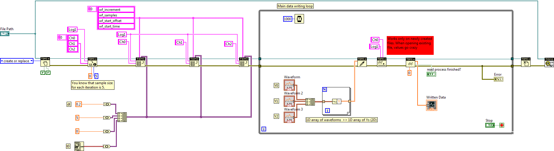

As suggested in the article, we began using the TDMS Advanced Synchronous Write along with other Advanced TDMS functions to deal with the memory growth problem. With the Advanced TDMS, we can separately set up the channel info before entering the data-writing loop. We have confirmed that the memory growth problem is almost completely gone! The RAM usage has become very flat indeed. Now there are two new issues though.
1. Waveform as input data type for TDMS Advanced

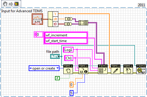

TDMS Advanced Write does not accept waveform as its data type. The input to the original TDMS Write was waveform data (Y, dt and t0). We need that complete information to recontruct waveforms. For a work-around, we are trying to separately input each component of waveforms in the TDMS files.
It's easy to deal with Y (data values) but how can we put dt (time interval between data points) and t0 (time stamp) in a TDMS file? In other words, when we open a TDMS file with Excel, we want to be able to see wf_increment (dt, Waveform x-start time in DIAdem) and wf_start_time (t0, Waveform x-step width in DIAdem) values.
2. How to read TDMS files while writing
With the old TDMS methods, we can open the TDMS files anytime we want while data is still being written to them. Advaned TDMS does not seem to allow this. Is there any proper way to open TDMS files written by Advanced Write while the program is running?
Please take a look at the attached simple VI. I put some comments and questions in it. If you find anything wrong or how to improve it, please help us.

Hello... Well, very problem-oriented nick you have, MemoryGrowth 🙂
1. What is the problem with using Set Properties for saving waveform dt and t0? You can even name them using default names.
2. What exactly is wrong with Adv Synch Read? I've noticed that it works fine when I create new TDMS file, but when I open existing TDMS, values return by Adv Synch Read are very random.
Please take a look at attached VI, I've modified your VI and placed comments at places of modifications.

1. "TDMS Set Properties" is supported to work with TDMS Advanced APIs. In your case, you can try using a non-empty value as property value input.
2. For TDMS Advanced APIs, data is not cached in memory for each write call. Thus, it's proper to use read while logging. You can use "TDMS Set Next Read Position" to locate to the position to read from and use the "count" terminal of "TDMS Advanced Synchronous Read" to specify the number of samples to read out. It will read all the data by default.

Here is a relevant example from applications engineer Zach, in case someone else may wanna take a look at it. In this code, timestamp for each data point in a waveform is recorded side by side with the data values.

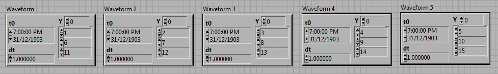

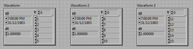

Quick question: Is there any way to save numbers I want in the Waveform Constants on the front panel? Data Operations > Make Current Value Default doesn't seem to work. If I save and re-open the VI, the numbers are back to the default values (Y: 1,2,3,4,5). Please consider the input below for the following example.

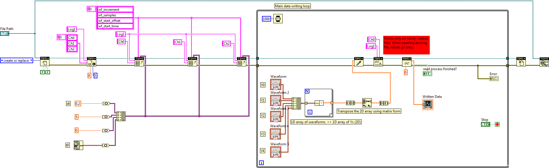

I simply added two more TDMS Set Properties for two additional channels. In this example, there are only three channels (Ch0, Ch1 and Ch2) but if there are a lot more channels, a For Loop may be used to set up the channel names efficiently.
In this case, Y0, Y1 and Y2 nicely correspond to Ch0, Ch1 and Ch2. Each second, it records 5 data values with 0.2 second intervals for each channel. Data is nicely saved in the TDMS file with corresponding channel columns.

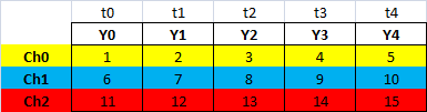

Now, let's consider another situation. In this case, each 1D array of data (Y) contains values for every channel. Consider the following input setup.
What is the best way to rearrange the data above so it can be nicely saved in the TDMS file just like in the first example? Since Transpose 2D Array didn't change anything, matrix functions were used. It would work well if the matrix was square but due to the uneven dimension sizes, it seems the transposed matrix retains junk columns. I can probably use Resize Matrix but this is getting non-generic and messy. Is there any nice way to deal with this data arrangement problem?

You can just set data to be interleaved instead of re-arrage your data as follows:
I have modifed your original VI for this case in the attachments.

Thanks, deppSu. The problem was something silly. For each 1D array Y, there were 5 elements, not 3. 2 last elements were just hidden. If you run the iteration once, it doesn't show up but if you run it more than once, you would see data is messed up. Since you added the 2D array indicator, I could see that easily.
I don't think the data layout setting (non-interleaved or interleaved) on TDMS Set Channel Information makes a difference for 2D array data. If the input data was a 1D array, filling sequence in 2D output format would certainly matter. In my example, it's 2D to 2D though.
I notice a Diagram Disable Structure was inserted in the code but the matrix manipulation part is on the Enabled side so it didn't change anything. If I replace the matrix part with a straight wire, data is messed up. It seems we do need transpose to re-arrange the data.
