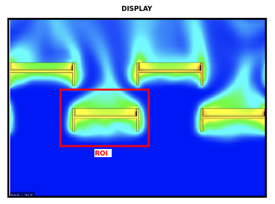

Hello!
Thanks for replying.
I would like to do the next in Labview:
1- Display the thermal image in a display on labview (like this):
2- User draw a ROI (a region of interest in a rectangle shape):
3- Then get the pixel with maximun temperature and show as an indicator in the same front panel.
Thanks a lot
