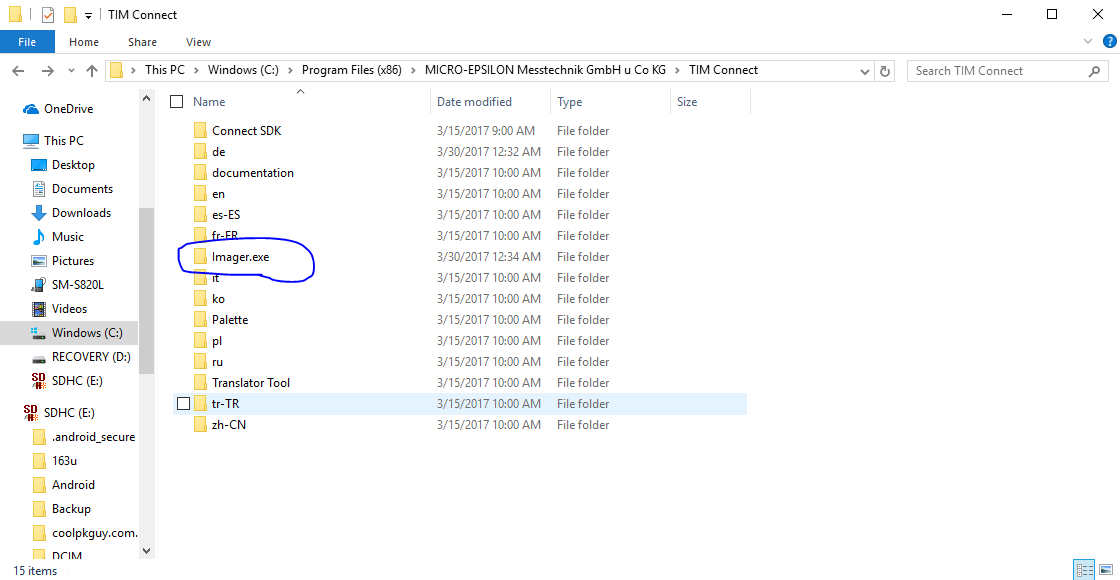

Sure thing bud. Here is a screen shot regarding step one.
This is the program source folder for the Optris PI Connect program. (C:\Program Files (x86)\MICRO-EPSILON Messtechnik GmbH u Co KG\TIM Connect). I downloaded the program from a company called Micro Epsilon, but I think it should be on the CD that comes with it. Notice how I made that folder named "Imager.exe"

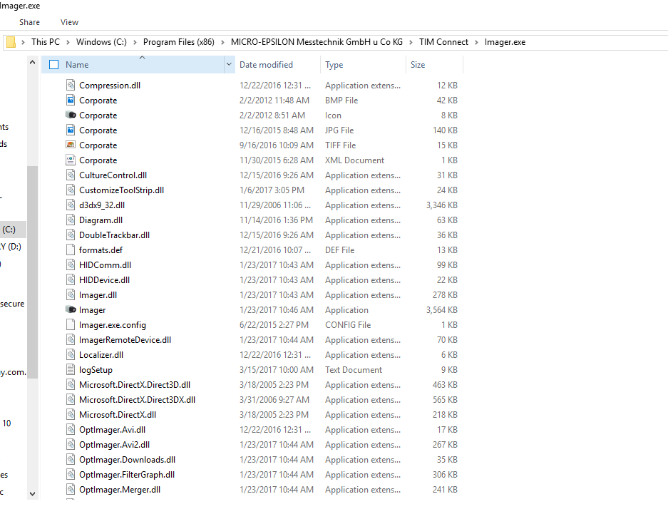

Now, within the Imager.exe folder, cut and paste all these files in there. These were originally on the source folder.
Now try running one of the example VI's that I included in my first post such as "IPC_GettingStarted-0.vi"
