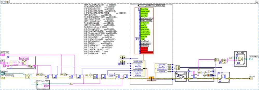

First you should of course show what you have done when asking for help!! We do not have a crystal ball to see what your VI looks like on your computer.
Second, expecting this scream for help already I reworked the VI to work for both 32-bit and 64-bit and also cleaned it up considerably. Still needs some more testing but this is what it will look like.
Rolf Kalbermatter  My Blog
Message 7 of 13

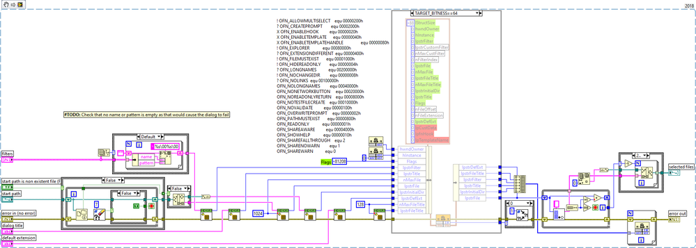

Accepted by topic author naveen_k
So I created the VI and did some prelimenary tests which seem to indicate that it works. This should work for both 32-bit and 64-bit LabVIEW. The attached ZIP file contains VIs that will work for LabVIEW 2009 and higher. Lower versions do not support 64-bit code options so this version can not be backsaved to an earlier version without significant modifications.
Message 9 of 13
