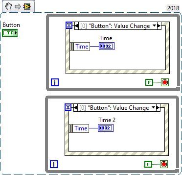

@LLindenbauer wrote:
Using multiple event structures on their own to catch the same event, e.g. a button press, does not work: The event is caught by only one of the event structures.
This is incorrect. While it's probably a "code smell" it will work, sometimes. *Filter* events will only be read by one structure, but not *notify* events. See this KB article:
https://knowledge.ni.com/KnowledgeArticleDetails?id=kA00Z0000019KnjSAE&l=en-US
Also try this snippet. Both structures will see the button press.
That said: I agree with everyone else that it's poor practice to actually DO this. For the snippet above, for example, you could only read the value of Button in one event structure (since it's configured as a Latch action). You could read that the button WAS pressed, and you can use the NewVal terminal to see the new value, but the actual "Button" terminal (which needs to be read to reset the Latch action) can only go in one place.
To the OP, a producer-consumer is definitely the way to go here. Just because you *can* do it doesn't mean you *should* do it 🙂 A message handling architecture will be WAY better.
Imagine this scenario: your GUI loop and your DAQ loop are both monitoring the button press for "Stop acquiring data". Let's pretend your DAQ code is attached to a device that takes 5 seconds to return data, and for some unfortunate reason your DAQ loop blocks during each data read. The user clicks the "Stop acquiring" button. The GUI loop now thinks the acquisition is stopped. The DAQ loop doesn't even see the button press for 5 seconds, so your loops are now out of sync. You'll have to add code to message between the loops to fix this sync issue anyway, so might as well do it from the start.
Now you have your GUI loop catch the button press and can send a message to the DAQ loop to stop taking data. And the fun thing is, now your DAQ loop can be used in other code as well, since it's just tied to a queue/notifier/User Event/channel wire/Actor Framework message/etc, so it's now decoupled from the GUI loop. Benefits all around!
I can't say that it's NEVER a good idea to have multiple loops access the same event, but I can say I've never needed it (not that I'm the authority on this, lol). I would try very hard to not do this unless I had a really great reason to do it. Possible reasons might be a global shutdown signal or a GUI toolkit that perhaps changed the color of a button on mouseover (like in an XControl or QControl).
