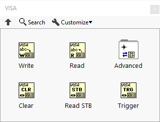

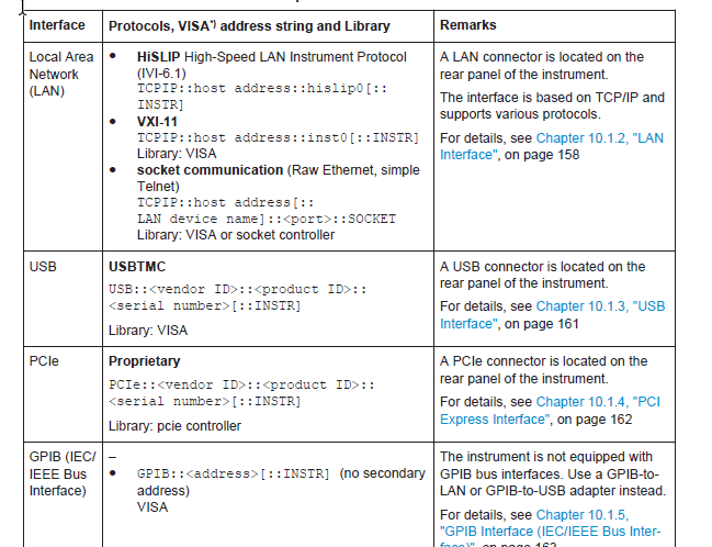

If you look on page 155 of their manual, you will see that the VISA library is supported. See screenshotSnap1.png
See library VISA, that means you can use VISA write and read commands; the commands are also in the manual, and it is 64 bit. Look at the Instrument I/O palette in LabVIEW.
