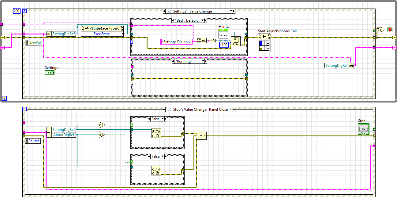

Here I added some code with checking the Dlg vi exec.state.
In "Stop" event, close the Refs of each Dlg.
CQ
(4,106 Views)
Closing the references is not going to stop the vis running if the front panel is not being displayed. You need to check the vi execution state and cause it to stop when the main vi that called it closes otherwise you will end up with a memory leak and funny behavior.

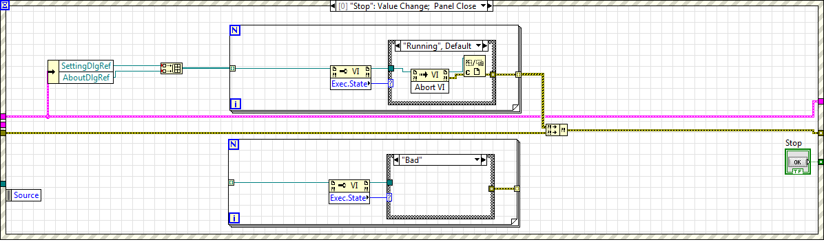

Will "Abort Vi" work? Here I check the Exec.state and use "Abort VI" to stop the Dlgs.

Yes it will - this is the same as pressing the Abort button on the front panel so it is not a recommended technique as it could leave any H/W controlled by the VI in an undefined state and is not good programming practice.
(Personally I would use this only on VIs which have the state "Running" at the end of the main VI as a secondary stopping technique. the Primary technique I would use would be to set the value of a Control (Invoke node) for the VI and then name the control and pass in the value by variant. - This allows you to press the subVI STOP button from the calling VI!)
