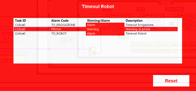

In the attached image you can see the "SelColor" property under "ActiveCell" but the color of the selection changes for every single row.
I was wondering if it's possibile to use the "Selection Color" property of a Multicolumn Listbox for the current active row only.

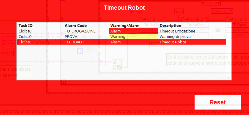

This is an alarms' listbox, I'd like to keep the red color for alarms' selections and the yellow color the warnings' selections.
This is the right selection (red selection for the alarm)...This is the right selection (red selection for the alarm)...
... And this is the bad one (red selection for the warning instead of yellow selection)... And this is the bad one (red selection for the warning instead of yellow selection)

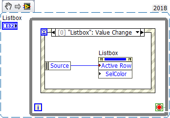

Try something like this:
That might be OK, but it might flicker.  If it does, do something like this instead:

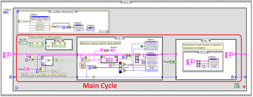

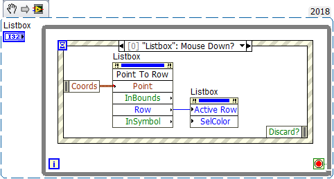

Your example works with single column listbox, I have a multicolumn one but I edited your code and tried it in a separeted VI, it works!
I simply get the color I need from a reference cell in the same row of the selected one and set the selection color.
Now the second issue: as you can see in the attached pictures I need to continuously run the "main cycle", which fills the listbox cells, while I check the selected row as you showed me, is there a way to make this work? The VI I attached doesn't work, I also tried to insert the "main cycle" in the "Timeout" case of the event structure but it doesn't work.

It doesn't work as shown because the loop will iterate after everything inside it has finished.  The event structure waits for an event, so it won't finish until an event happens.  When you put the Main Cycle in the timeout case of the event structure, what did you set the timeout to?
Message 7 of 8
(5,449 Views)
Poor me... I didn't set the timeout 😪
Now it works like a charm! Thank you so much Paul 😁
