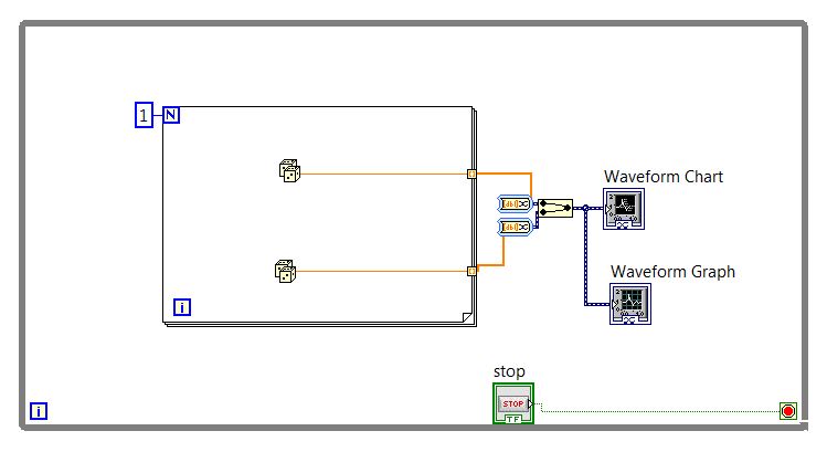

A single point would be wired directly to a chart indicator.
Your image does not seem to have anything to do with your question. The single point acquisition would just be inside the whole loop - no for loop. It's also silly to convert to dynamic data.
With context help turned on, move your mouse over the chart to get a description of the possible data types for a single or multi-trace chart.

hi Dennis,
The convertion is automatically done by Labview.
And, I have 2 channels, so I can't wire them directly to 1 chart / 1 graph.
Also, I use for loop to test more than 1 data, e.g. 10 data, i can see those 10 points in the chart.
But, what i want is to be able to see previous data as well as current data plotting in a scope / chart.
Do you have another possible solution?
(2,941 Views)
Here is a quick example showing chart, graph and XY graph.  All YOU need to do is use a chart and wire your DMM reading right to it.  Charts have their own built in history (you can change the buffer size by right-clicking > Chart History Length)
