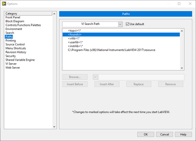

How to view/edit the list of found VIs, i.e. <foundVI> Symbolic Path
In the Options dialog > Paths page, under  VI Search Path pull down, there is an optional symbolic path called <foundvi>.
The help states
"<foundvi> refers to a list of all directories where you have previously located a subVI. During a search, LabVIEW adds to this list any directory in which LabVIEW finds a subVI. <foundvi> helps you locate a directory of VIs that has been moved or renamed. When you open a VI that calls another VI that has been moved, you must find that directory only once and then LabVIEW adds this path to the list of directories."
Where is that list stored? I've read elsewhere in the forum that it is kept in the LabVIEW.ini file.  However the only path entries are for "RecentFiles.projectPathList" , "GSW_Pinned_Files" and "RecentFiles.pathList".
