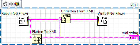

Or If Labview schema is acceptable, it is fairly straight forward.
