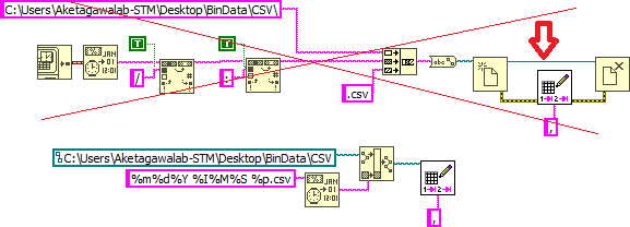

Nobody in his right mind will touch your code, but let's focus on the spreadsheet write.
You open and close a file, but you never wire a path to the file write function.
You should also NEVER operate on entire paths as string
Format date/time assumes current time, no need to wire a timestamp
The way you process the time string is dangerous, because it trims leading zeroes from the month. This makes it ambiguous for many dates.
Here's a working alternative

If yo look inside "write delimited spreadsheet" (yes, it is just a plain VI where you can look at the code!), you can see that it already does various tests and opens/cluses the file. All it needs is a path! In your case it should have given a file dialog popup, which you should have seen.

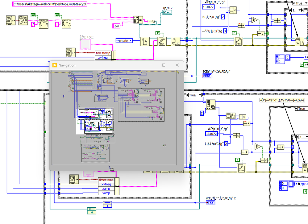

However, Gerd's point is important, because your VI uses "file open" quite excessively in other parts (there are 10(!!!) instances scattered all over that gigantic diagram!!) and some seem to have unicode(?) file names hardwired. All file names seems to be base on time and thus always new.
This program is such a hairball that it should be tossed and rewritten as a simple state machine that fits on one screen. There is no way to reasonably debug this, because I can only see <10% of the code at any given time. Here's how the navigation window looks like! There is way too much convoluted and duplicate code! There is a lot of code smell!

Thank you for your reply.
I was able to modify the program you attached and save the CSV file.
The data in the file was also correct.
Thank you very much.
I apologize for the complexity of the program, which is difficult to see.
I will try to think of a way to make the program simple enough to fit on one screen, so that the complicated parts can be summarized.
