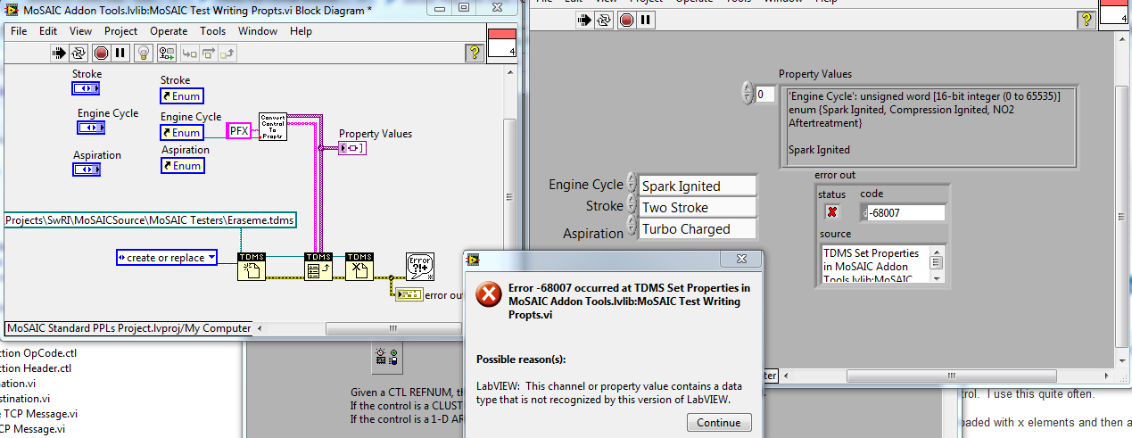

I need to convert a structure of arbitrary complexity into properties, suitable for writing to a TDMS file, in such a way as to be retrievable, and (hopefully) to be human-readable, such as whn the file is loaded into DIAdem.
I have most of it working just fine, but I have trouble with ENUMs.

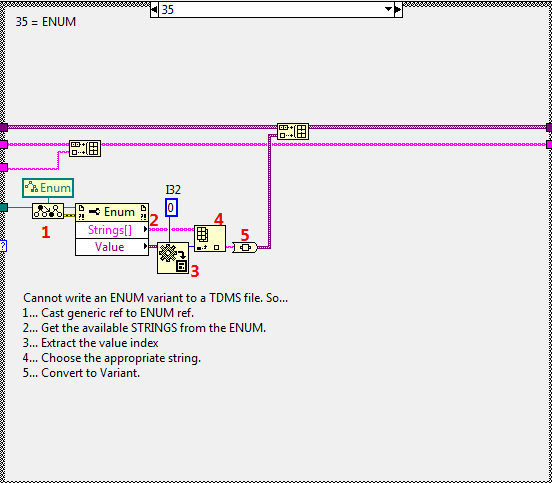

An ENUM can be converted to a VARIANT just fine, but writing that variant to a file produces error -68007.
A simple test shows this:

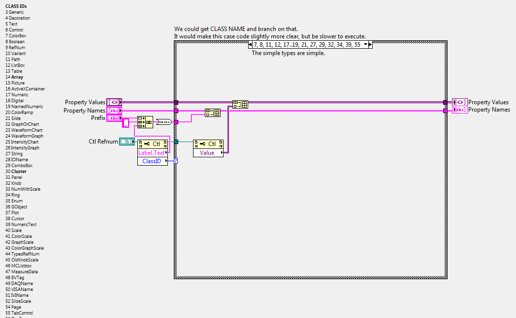

The encoding process is fairly simple - given a generic control Ref, just look at its CLASS ID.
If the ID is one of the basic ones, just get its value as a variant, and append to the NAME and PROPERTY arrays:

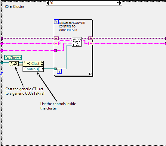

If the item is a CLUSTER, then just get the controls within it, and do them one by one:

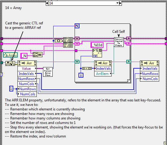

If the control is an ARRAY, then it's a bit more trouble.  Since there is no way to get a reference to an arbitrary reference, you have to use the one reference to an element that you have.  To use that, you have to be showing one and only one element.  So this code does that, while restoring the original view:

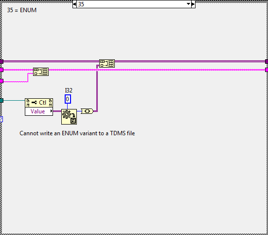

The ENUM, as I said earler, converts to VARIANT just fine, but TDMS will not accept it.
Here's one technique that works, sort of:
By converting the enum to an I32, you get the numeric value of its current setting, and can put that into a variant.
When reading, the numeric value will set the ENUM control correctly, so that's good.
The trouble is, in DIAdem, the property will look like:
Whatever_Engine_Cycle        2
While that is true, and will read back OK, it doesn't tell the user what kind of cycle it was.
The point of ENUMS was to put names on specific numbers.
I tried converting the variant to a STRING instead of an I32, but error 1057 (IIRC) happens: "cannot convert variant to specified type".
A similar issue exists for TEXT RING controls - although they will go through the process without error, what shows up is a number.
Any ideas for making DIAdem display the ENUM's string value, instead of a number?

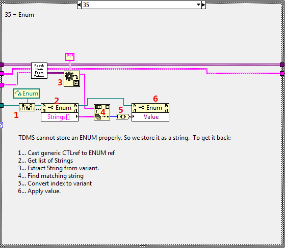

Nice clear post! let's try for a elegant solution.  I think you are half-way there!
You know from the Class ID its an enum  so cast the generic to enum
This may not work with type-defs I'll leave that to you.  Rings and text rings can be handled simillar
Edit: Obviously cast string to variant
DUH !  ( slaps head )
I danced around with that earlier, but I was thinking that the strings wouldn't survive a downcast from ENUM ref to CONTROL ref.
Of course, that's not the case - It's just the REFERENCE that changes.   If you convert it back to generic ENUM, then you can treat it like a generic ENUM.
Thanks, Jeff !
For completeness, here is my ENCODING code (enum ---> property):
On the other side, we do something similar:
Works like a charm.
Thanks again, Jeff!

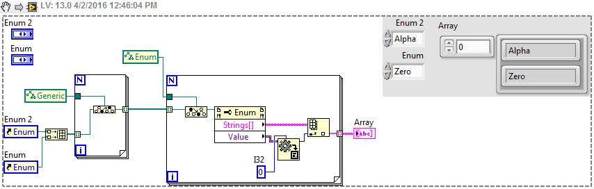

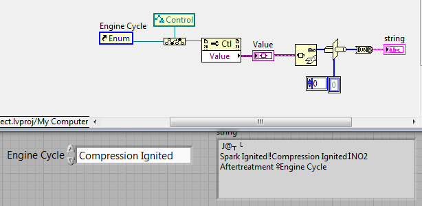

For the record, the VALUE variant of an enum includes the possible strings, as evidenced in the original post above.
If you FLATTEN that into a STRING, you also get a DATA TYPE output (array of U16).
If you case THAT into [U8}, and then into STRING, you can see that all the possible strings are in there.
The DATA STRING out of the unflatten encodes the current value.
Still, using that would involve parsing out the TYPE STRING stuff, probably not a good plan.  Unless that's documented by NI somewhere.
