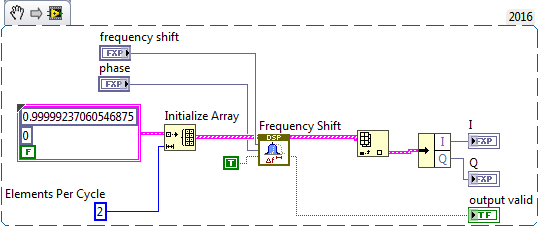

The DDS Compiler would probably give you what you want. It can be a little tricky to configure, but it will be the most resource efficient way to generate a signal on the fpga.
If you don't mind a little extra resource usage though, the easiest way to generate the signal you're looking for is by using the frequency shift.vi that ships with the DSP library. The idea is that the frequency shift.vi can applies a shift to the IQ data, so if you connect a constant to the data input you're essentially shifting the frequency from zero to whatever you want and the output is an sine/cosine wave at whatever frequency you want. The nice part about this library is that since it is intended for use with our RF products it already outputs I and Q components. Its also got a phase input that allows you to change the phase as you see fit. If you need to modify the amplitude, you can connect the output to the Gain.vi that is also a part of the DSP library.
