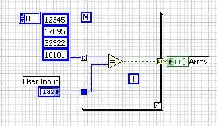

I have a similar situation. Instead of displaying all the data at once I want to step through the data and compare each number with another number. Here is an example of what i am talking about. Lets say my text file contains the following
12345
56789
98765
54321
I want to go through each of these line and compare each number to a number inputed by a user. How would I step through the array?
(3,043 Views)
Use a For Loop with auto indexing enabled.
