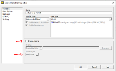

The Network shared variables are only read, at the side of the GUI. The cRIO reads and writes this data, and hosts the variable server. I did try to find a way to make the network shared variable read/write for all code on the cRIO. While blocking other devices write acces, such as the GUI Monitor PC's on the network. I could not find a way to achieve this. If it can be done can someone please explain how I could do this?  I can see a acces type defined at the properties of the network-published variable but it is greyed out:
