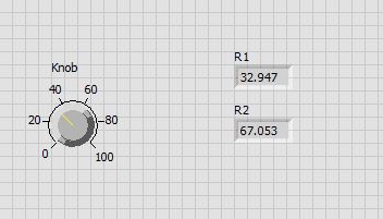

I am not sure what that device you showed wou be good for electrically but here is what I came up with.
As you turn a single knob R1 increases and R2 decreases

Here's a couple pictures you can follow
Block DiagramPanel

I think you are going to have to create a custom control to get exactly what you want.
It's kind of cheating but you could try stacking two "knobs" and play around with making parts of one transparent so it looks and acts like one "knob".
Then using property nodes you can adjust the scales and make then inversely track each other.
