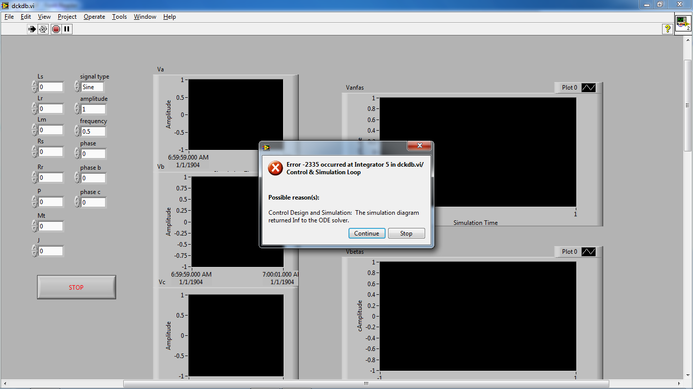

I have simulated  asynchronous motor 3 phases, but it cant Run, I dont know how to fit this problem.
this is a problem.
error

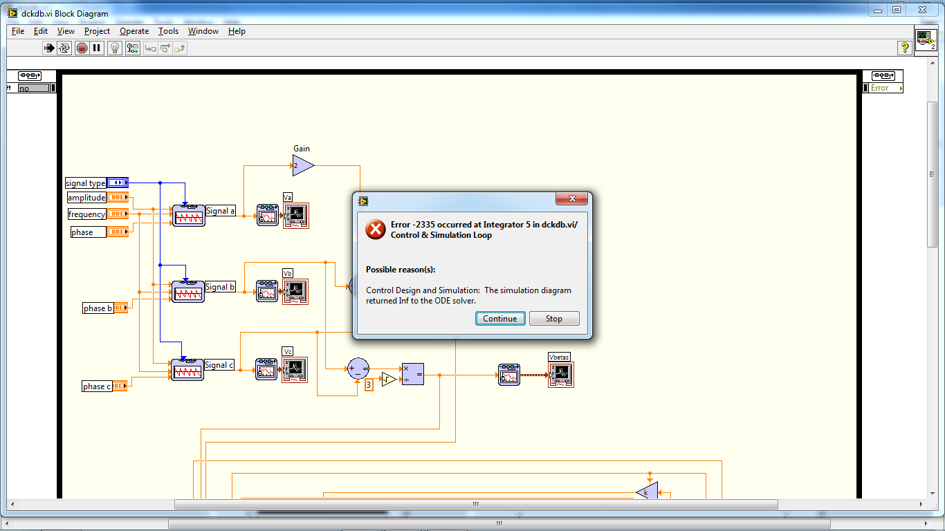

and this is my project.

This error means that an invalid value was passed to integrator block 5 (If you show visible labels on the nodes you can find Integrator 5 to be at the top).  A value of infiinity typically means the value was divided by zero.  The division comes from LS*LR - LM*LM which in your screenshot would be zero because LS, LR, and LM are all zero.  You also need to give a value for J because it's used as a divisor for Integrator 9 at the bottom.  If you give values to these controls it no longer returns error 2335.
I've included an updated version that I used to test.
Let me know if these changes don't help or if you have any questions about this error.
