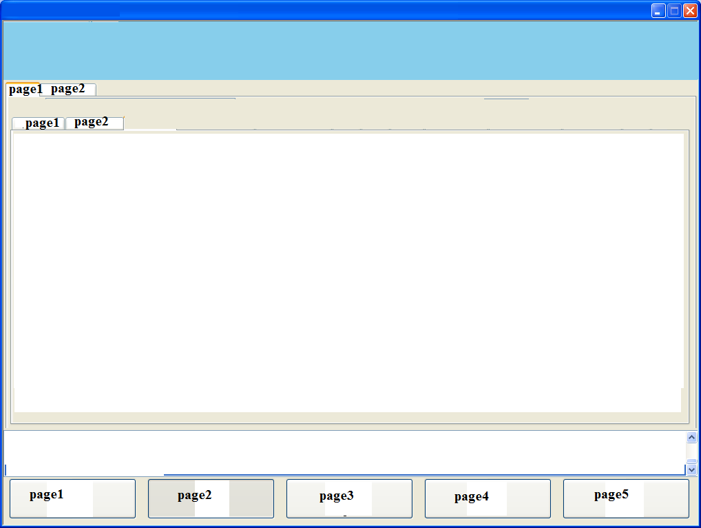

I need to design Front panel like this
I need to Desging my front panel design like this
Help me to find out this !!

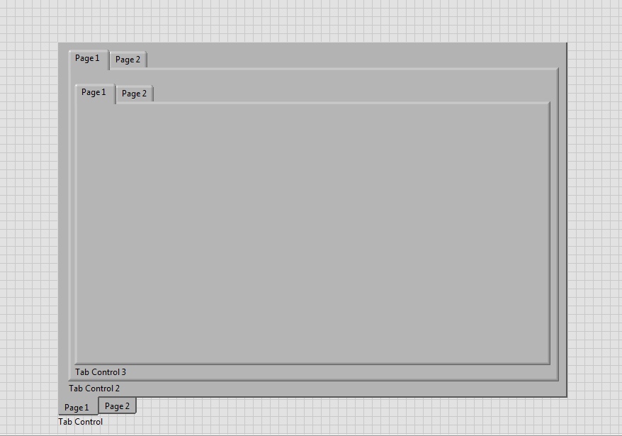

Hi saran,
looks like a tab control inside of another tab control. Below those tabs is a string indicator and some buttons.
What have you tried?
Where do you have problems with?

Tab inside tab is no Problem.
But the Bottom one is not Buttons thats also Tab Pages

Hi saran,
so you already know what you need? Then why do you ask?
In your first image they look like usual System buttons to me. I would use buttons to switch a tab control with hidden tabs…
Btw. stacking 3 tab controls with several pages doesn't sound like a good UI design approach to me. But that's just my opinion…

"I would use buttons to switch a tab control with hidden tabs…"
This buttons to switch a tab " can you give me any sample vi

Hi saran,
you use those buttons to write a new value into a local variable of your tab control.

Hi saran,
that's a fine solution using the event structure!
One remark: as of now you use your buttons like radio buttons (only one selection at a time allowed). Why not use real radio buttons?

Hi saran,
I dont know how to do that !!!
- Put a radio button on your front panel.
- replace the existing buttons by buttons of your choice to get the look&feel you want.
- add as many buttons as you need to this radio button
What's the problem with theses easy steps?
