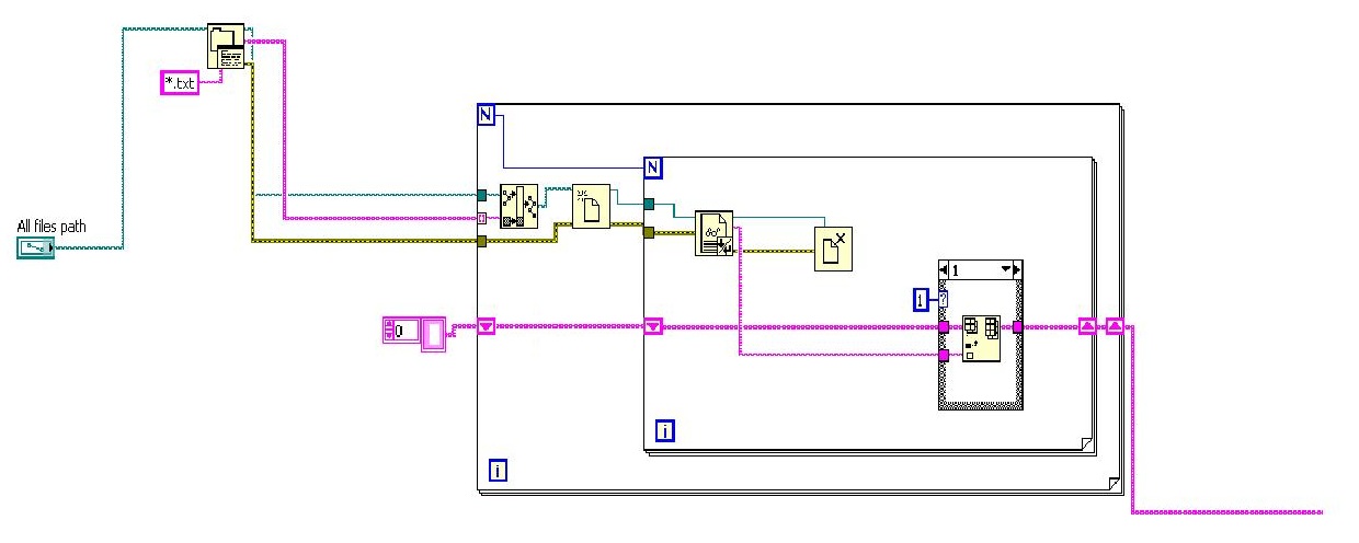

I want handle single array for multiple files
In previous post.. i have doubt in reading multiple files .. i successful did that with ur help..
i have array storage .. in that i want to store all data or group by file data..
if i run the VI. data that present in the last executed file will be storing in the array.. i want to proceed futher .. so i want all all to proceed further

Move and connect the 'empty array constant' connected to the shift register of inner For loop to outer For loop's shift register.
Edited: picture attached for illustration.
Code_Modified

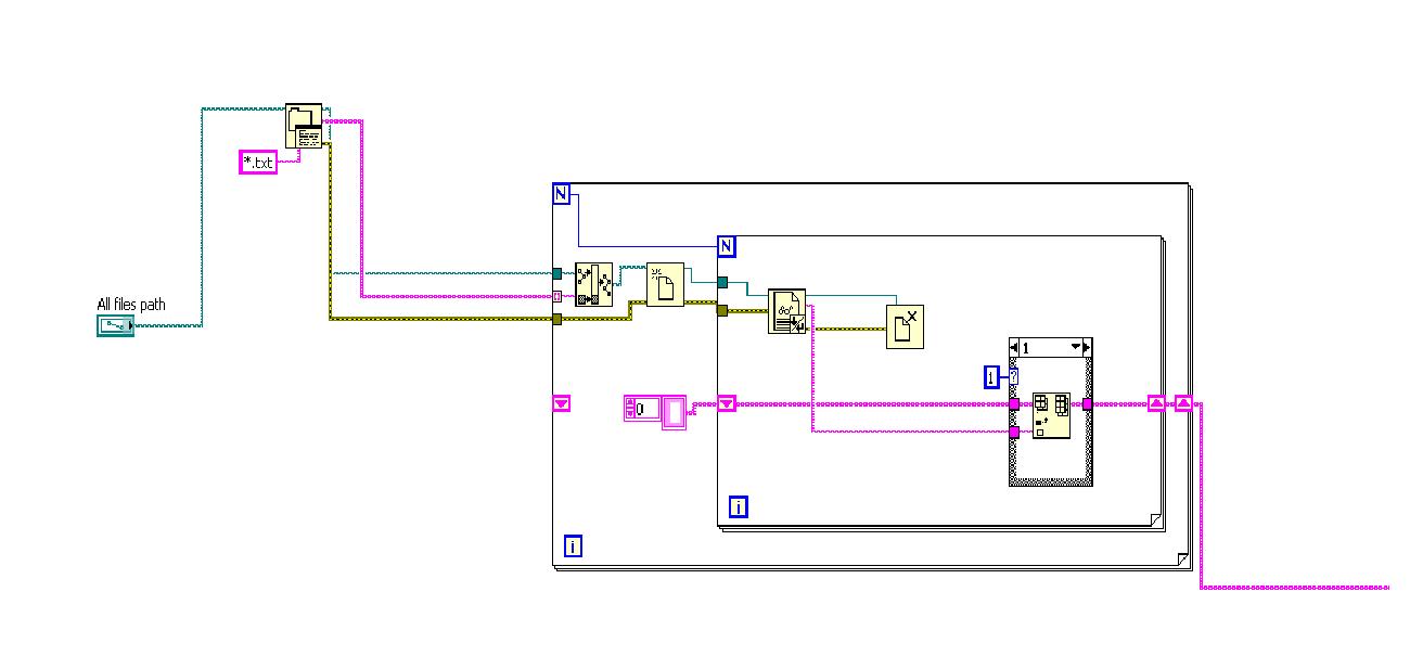

I would get rid of the second For Loop and the Case Selector that is in the second For Loop. Right now, they are doing nothing.
(3,340 Views)
Simple and less clutered 😄
Functionality is slightly modified, the output in this case will be a 2D array... OTOH, the requirement was of 1D array.
With LabVIEW 2012, this can be done by right-clicking the output tunnel and selectingTunnel Mode»Concatenating from the shortcut menu.
