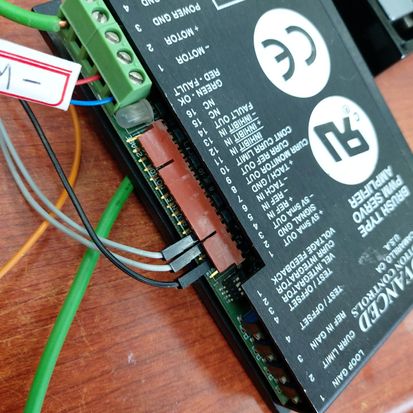

I want to control a dc motor using a pwm amplifier
I took over the assignment of a previous researcher. He used this pwm amplifier to precisely control the dc motor, and I would like to know what the role of this pwm amplifier is at that time. Is it a role to amplify the signal made by myrio? Before this, signal gnd, +ref in, -ref in pins were connected.
Yes.
Yes, the DC motor current draw is probably too high to be driven directly from the MyRIO.
