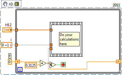

Here's a snippet as a draft/starting point:
(4,304 Views)
