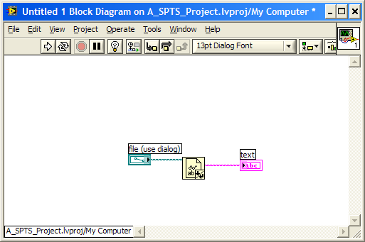

One of the great things about labview is how simple it is to run small snipits of code... Do as altenbach suggests, break it down.  You might start by just creating a new vi and plopping down a "Read from Text File" vi. Select your text file as the file path and run it.  Once you have read the file, then you can start experimenting with string parsing functions...

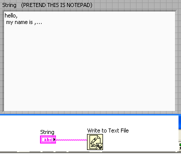

Here is something even easier.
Just place a string control on the front panel.  Make the box as large as needed.
Go to the block diagram and wire the string control to a Write To Text File vi.
Type stuff into the string control (box) and then run the VI.  It will prompt you for a filename.  Give it a filename with extention .txt.
You'll be able to double click the newly saved file and open it with Notepad.
It's a starting point...  THen you can expand.
