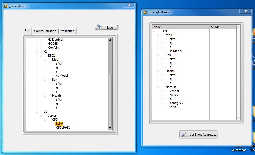

Which "blue box" do you refer to? Do you mean _CreatePublisher.vi or  _CreateClientFromSCL.vi? If so, you can double click this VI and find its next layers VIs. The function of this VI is loading ICD file and making some basic configurations for Publisher or Subscriber.
4. Right now the publisher starts with a boolean, a unsigned integer and a time, but even if I change one of those, i get the error. So I am assuming I have to do something in the SCL file, but am not sure what.
Same as the question1, if you want to do some changes for data, modifying ICD file is the first step.
You can use the IEC61850 SCL Utility.vi to browse your ICD file, like follows. Let's say S1->Server->CFG->LLN0->Mod, you can control stVal, q, t and ctlModel in VI. So if you want to do some changes for nodes, you should change the ICD file firstly.

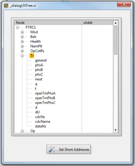

In the Publisher.vi, you can see the point address, "E1L1/PTRC1$ST$Tr$*". Give you a brief explanation about it.
1. E1--IED (intelligent electronic devices)
2. L1--LD (logical device)
3. PTRC1--LN (logical node)
4. ST--DataSet
5. Tr--DO(data object)
Then run the IEC61850 SCL Utility.vi. Load the IEC61850_GOOSE_example.icd and find the E1->P1->Server->L1->PTRC1. Double-click PRTC1 and popup a new dialog. Then find the Tr like the below screenshot. You can find the index 1, 5 and 6 in Tr is phsA, q and t.
In the Publisher.vi, you can find the index1 corresponds to Phase A, index5 corresponds to Quality and index6 corresponds to Timestamp in the While loop. This is the correlation between VI and ICD file.
For the IEC61850_GOOSE_example.icd, Tr is a part of the PTRC and be defined at P479. And the type of Tr is ACT. The ACT is defined at P877. So the ACT is the actual defination of this type. You can find the contents of ACT are same as the above screenshot.
As a result, you need to defined custom nodes and their hierarchical structure in ICD file firstly, then make the correct path and index in VI to read/write them.
