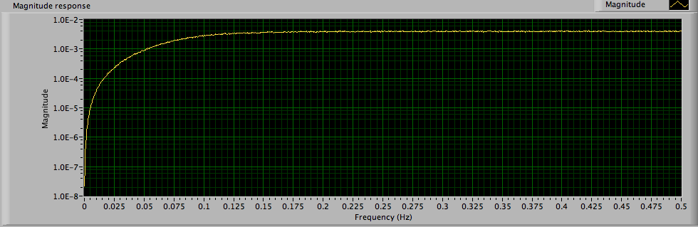

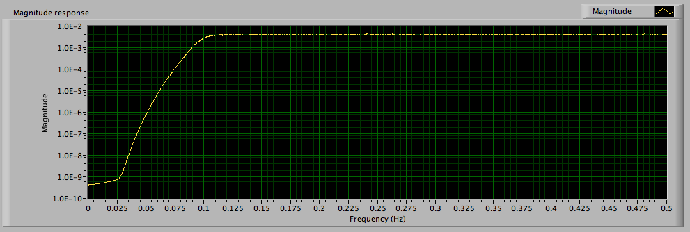

I tried an alternate approach: I generated a random noise signal. Uniform White Noise has a flat spectrum. Then I fed that signal to the filter and took the spectrum of the filter output.  The average of a large number of runs represents the spectral response of the filter.  This image was taken with Butterworth Bandpass, 12th order, Lower Fc = 100m, Upper Fc = 3.0, Fs = 20, #s = 50k.
Lynn

I do not recall why I used the 12th order filter.  Here is what I see with a second order filter.
Lynn
