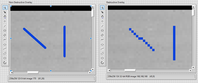

I'm trying to overlay lines in an image for publication. I'm facing a problem when I try to overlay angular lines. Please refer the image below.Overlay ResultOverlay Result
My goal here is to make the Destructive overlay exactly as Non-Destructive overlay! Is it possible? Has this occurred to anyone? Any help would be really appreciated! Thanks in advance...

The non destructive overlay is a vector rendered by Labview which is why it still looks smooth when zoomed in. Merge overlay will rasterize that line. You can copy the view of the display with the current zoom level by right clicking > Data Operations > Copy Data and paste it as a bitmap image.
If you want to save the image to file with the overlay and present it again with Labview you could use the option PNG with Vision Info. Be sure to read with Vision info as well.

Actually, I knew that concept! but the End Customer asks it in jpeg/bmp/tiff/png and they will use normal image viewer...
