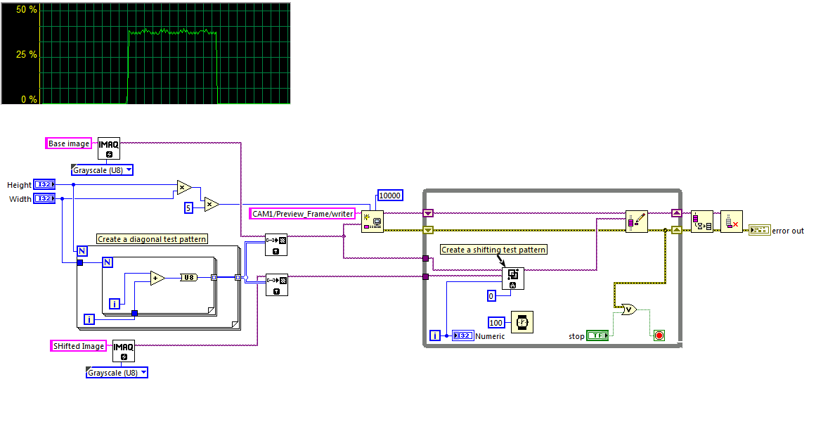

Here's the example I was working on.... The graph shows the host PC's 1Gbps network while the VI shown below is running on my RT chassis.  The frames are received as long as the IMAQ data types match exactly (Hence the connection of the output of IMAQ array to image directly to the type input of the create network stream vi).  What's going on under the covers to make this work, I can't really say...
