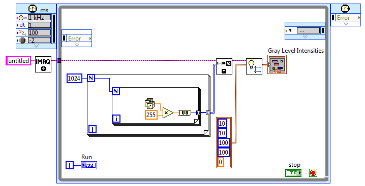

Yes, here it is;
the screenshot shows the light meter which is disabled; than there is no increase in memory usage in time.
If I remove the disable structure, mem usage grows gradually
Thanks for looking into this already
Bruno

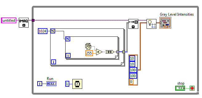

For me it works stable

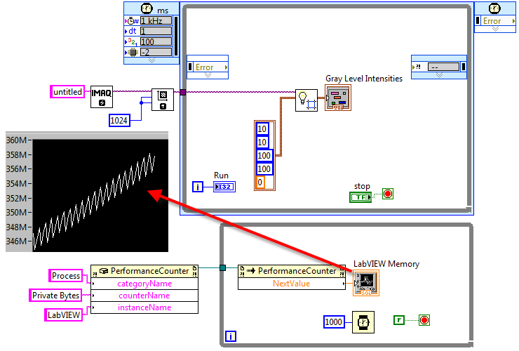

Got it. Seems to be memory usage increases when Timed loop used. Something wrong with threads.
Try to replace Timed Loop with simple While loop in your app.

Can be submitted as clear bug in VDM (I using LabVIEW 2010 / VDM 2011)

I tested it with a normal while loop, and it's the same, increasing memory usage.
I tried it in a small test program to ensure nothing else matters.
again disabling the light meter helps keeping memory usage constant.

No, with IMAQdx I unable to reproduce this behaviour.

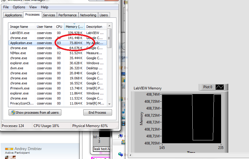

Ok, i see now, we are looking at different numbers:
In the graph of your vi, indeed, it stays +- constant.
But I look in the task manager under processes, and then  the memory tab as shown below.
Although the graph stays constant, mem usage keeps growing in the task manager
when I disable the meter, memory usage stays constant  in the task manager aswell..
