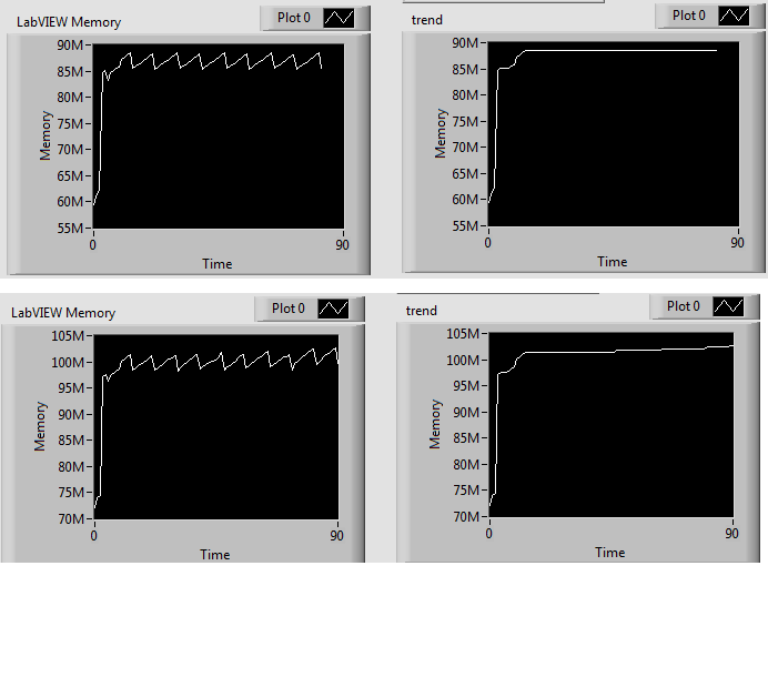

I did some more testing to be sure:
Below an image which shows on top the program with disabled light meter, bottom with enabled light meter.
The left images are the through memory usages; on the right, always the maximum
you see that on the bottom right image, the memory usage slightly increases, top right not.
all done with your vi (normal while loop)
Bruno

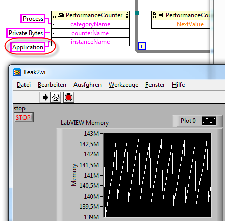

When performing check in builded application you should change instance name (otherwise LabVIEW's memory shown instead of application on the graph):
As you can see also in builded application it works stable for me. Not sure which memory exacly you checking in Task Manager, but working set and private memory both are stable (well, they changed +- 3 MB as you can see, but over long time they are stable). In Task Manager I also don't see any leakage for the application.
Yep, I see.
Try to insert IMAQ Clear Overlay directly before Light Meter:
(or turn off Show Search Area)
Andrey.

@Andrey Dmitriev wrote:
Yep, I see.
Andrey.
with the IMAQ clear overlay between the nodes, it's stable here.
I'll use that solution allthough I see that the through problem is in the light meter itself (not clearing all its memory every time)
Thanks!
