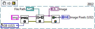

Accepted by pakopon
Is this the sort of thing you are after?
(obviously this isnt from a video stream, this is just a nice easy way to mock up the idea)
Your 'invalid image type' error can be solved by defining the image type as RGB, rather than the default Grayscale (see bottom left of above snippet)
