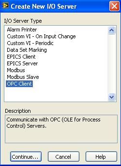

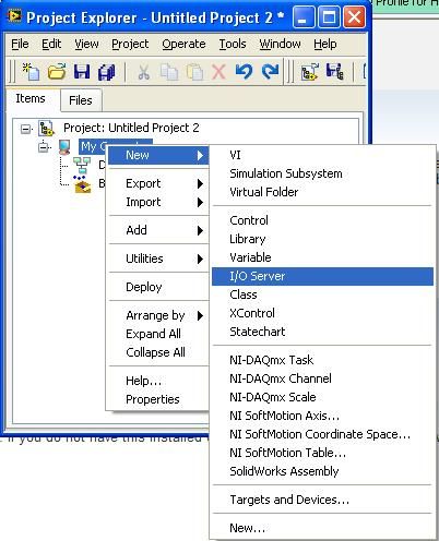

Hello Maad,
Follow below mention steps to create OPC Server
1.
2.
As Peter Says first check your installation is correct or some error is there.
For checking purpose you go Start » All Programs » National Instruments » NI OPC Servers » NI OPC Servers
Configure your OPC and check you are getting something or not.
