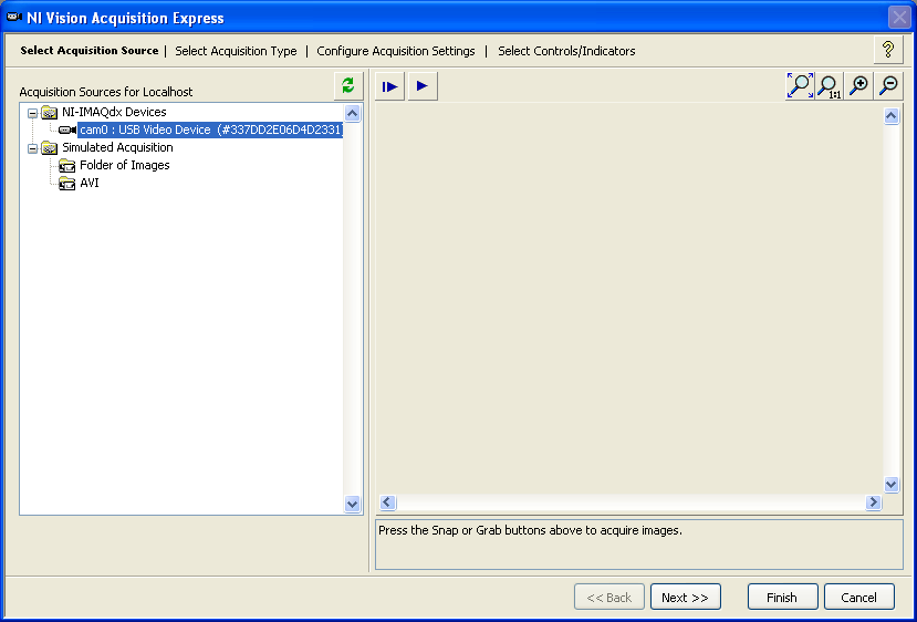

Even while operating the VISION ACQUISITION EXPRESS VI from the VISION AND MOTION PALETTE when i am not able to detect either the integrated webcam of the laptop or the IP WEBCAM that i intend  to use in the project but i can acquire images from the integrated webcam using the NI VISION ASSISTANT. I have even enclosed a pic to highlight the problem i face regarding the interface between the camera and labVIEW.

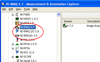

Well, you should check in MAX, if you've installed IMAQ drivers.
Is IMAQ Installed

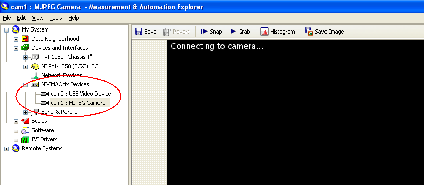

Also in my laptop, I can see atleast Laptop's webcam listed in MAX.
USB Camera listed
After doing settings, even MJPEG cam added to the available camera list (in MAX).
however not able to connect to the Android camera.

i had downloaded an NI package which said that it had imaq dx driver but the same is not reflecting in my NI MAX. so will have to install it again.thanks indeed.
