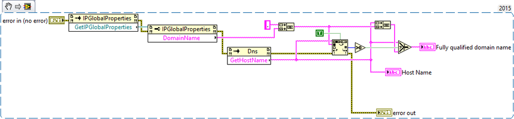

Where I work it's common to have PCs with multiple network cards, one on the "real" network and another 1-4 that connect directly to equipment.  Because of this we can't use the simple "IP to string" node because it often returns the IP of one of the local equipment's network cards instead of the "real" network.
As such, we use this code to get either the PC name or fully qualified name:

Thanks @Kyle97330 for the snippet! It executes a lot faster on my system while on the VPN than the built-in IP to String (~0.5s vs. ~4.5s), while yielding the same fully-qualified domain name. May take some further investigation (using Wireshark per altenbach's suggestion) to better understand why.
