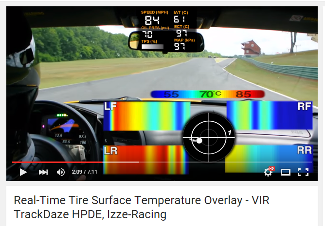

I'd like to display this data real time in a similar fashion to this video. Basicly have a 1 graph per tire with 3 temp values per graph and the color interpolated in between based on magnitude of each temp.
Any suggestions in how to accomplish this? Or a better way to visually display this data.
Video of what I'm hoping to achieve:  https://www.youtube.com/watch?v=VWNNl__Rbmc

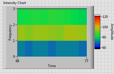

So far an intensity chart is the best I can come up with. Rotate it 90 degrees and only show the last 1 value rather then 10 and it's kind of in the right direction.

Hi cyotani,
use an intensity graph instead of the chart!
(2,989 Views)
I suggest image function you can use them to make plot area as like you want
