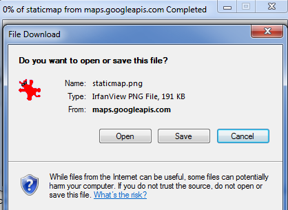

we have an old piece of code in LV11 which downloads a static map picture from google maps into the IWebBrowser2 indicator.
When reopen the project - or building or starting the exe - this message appears:

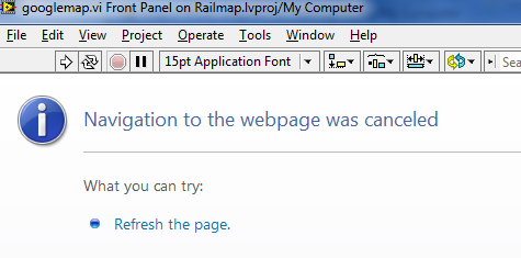

The vi looks like this:
2016-06-27 16_26_04-googlemap.vi Front Panel on Railmap.lvproj_My Computer.png
It seems, that even loading the vi into memory at project open without execution forces the element to load the last content.
how can this behaviour supressed? could not find any settings

Is there a VI in the project which is configured to "run when opened" (VI Properies >> Execution)?
