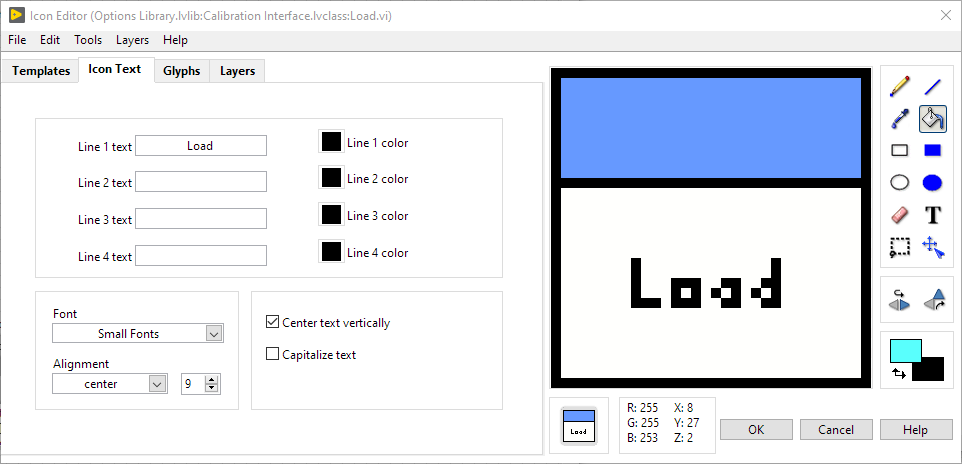

Hello Bob,
Here is a screen shot of the tab in the icon editor I am having a problem.
Everything else in the icon editor seems to be working fine.  I checked my computer performance and everything seem OK.  All other programs seem to be working normally.

Ah, thanks for showing this example.  I completely agree!  I solved this so many years ago that I forgot it was even a problem!  Change the font size from 9 point to 10 point and the text will be so much better!  Sorry it took me so long to realize the problem ...
Bob Schor
Message 9 of 12
(4,765 Views)
