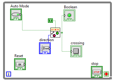

edit: Am I missing something? Currently, I can see the input toggle inside the boolean crossing function, but nothing is triggered...

Hi riahim,
why do you constantly reset the boolean crossing function?
(What is this boolean TRUE constant good for?)

I don't want to constantly reset the function. I figured I needed a way to initialize the boolean crossing, but now you bring up a good point. Do I only need to initialize it once or can I leave this disconnected...

Hi riahim,
you have several options:
- leave it unwired
- init by comparing loop iterator "i" for "=0"
You should also put a small delay (aka Wait function) into the loop. No need to iterate as fast as your CPU allows…

Thank you! It is now working
