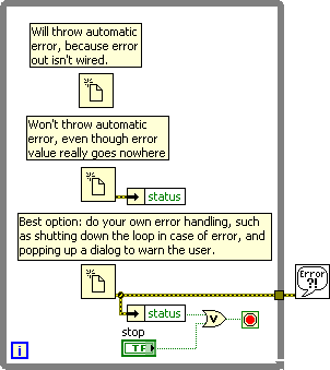

You can also get around automatic error handling in your code itself. The dialog only pops up if a node such as a subVI produces an error as an output, but that error value isn't wired anywhere. You can see in your code that the DAQ Assistant's Error Out terminal isn't wired anywhere. If you wire this error to anything at all, even just to the border of your loop, then automatic error handling won't throw a dialog when you run your VI and encounter an error. Since you are wiring that error value somewhere, LabVIEW sees the error as being handled by you and doesn't do anything.
