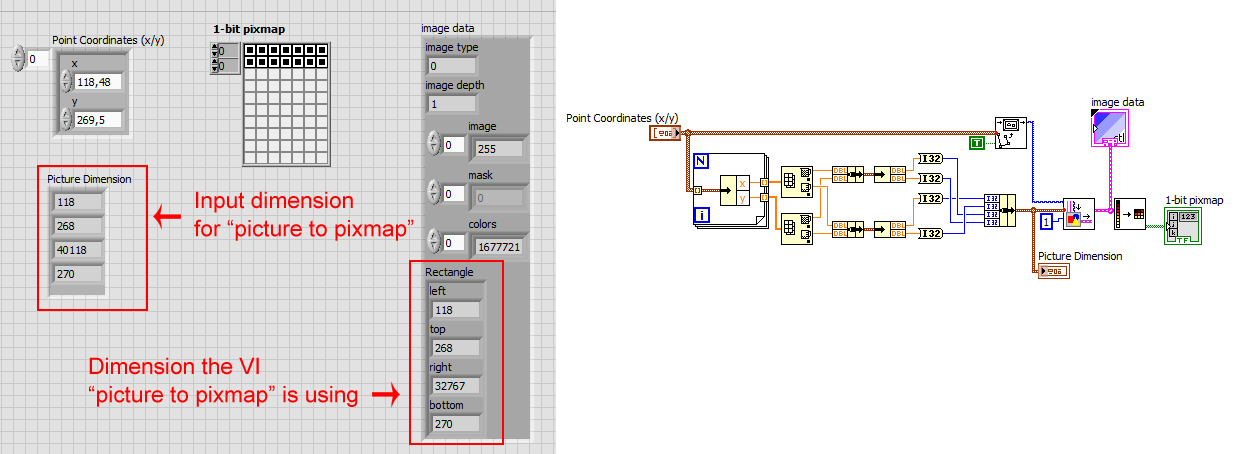

iam trying to convert a picture/image to a 2D array ... doesn't matter if it is a 1bit- or 24-bit pixmap.
the problem iam facing is that the dimension of my picture is too big for the VI "picture to pixmap" cause that VI only allows max 16bit integer ... so anything bigger than 32768px get's cut.
here you can see what i mean:
i've tried all day long to find a workaround ... but i wasnt succesful. maybe you can help me. 🙂

thx for the fast reply, zou!
i think that doesnt work cause that would require that the picture on the front panel got the wanted dimension.
i've just tried it and i cant get the picture wider than 16006px (see attached VI).

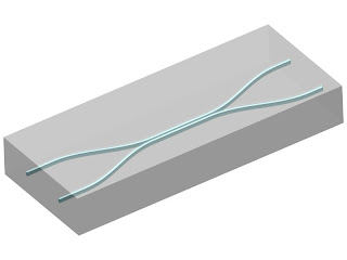

i really need all these pixels. i'll explain the idea behind the program:
i have a map of let's say 2mm x 2mm and i want to write a shape like this one which is equally large (2mm long, 1mm wide):
the given shape is available as bézier curve and i then define a grid size (e.g 20nm) to subdivide the edge of the shape in equidistant point and calculate those coordinates (x/y).
these are the coordinates that go into the VI "draw multiple points" as input.
in the end i need a 1d array of cluster of 2 elements (x/y point coordinates) of the given shape (with filled interior) as well as a BMP of this shape for a process called EBL where an electron beam draws that shapes on an electron-sensitive resist.
every black pixel in the picture is written and is essential for the shape.
