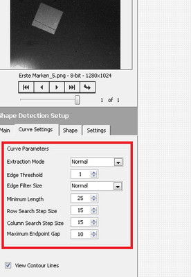

Hi, thank you very much for the tips!
I used the Brightness, Threshold, Filter functions, in this order. You were right, the rectangle looks much better now, the edges are almost straight. The lines are very easy to be found by the function Shape Detection, but I still cannot find the Rectangle (see the enclosed pictures). The image before processing is enclosed as Erste Marken_5.png. The results of Shape Detection function is to be seen in the other two pictures.
Maybe there is something wrong with my settings in Curve Settings in Shape Detection function. I do not understand all options there (picture below.)
Thank you very much in advance for the next tips.

HI Pers,
You can use Geometric Matching/Pattern Matching instead of Shape Detection.
Message 8 of 8
